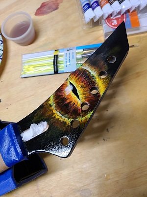

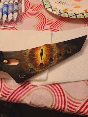

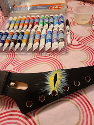

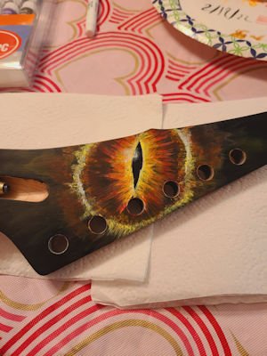

As promised, here are my WIP pics for painting with acrylics then sealing.
# 1 - 3: the Eye of Sauron in progress.
#4: fixed the flat spot that developed in the lower right corner that you can see in #2 and #3. Also went over the edge of the eye with more yellow to make it look less green as in the earlier photos.
After I was happy enough (and recognizing that tipping point when I'd start to over-work it and end up ruining it), I coated it with Zinsser spray shellac.  Let that dry overnight, then I hit it with two coats of clear lacquer.
