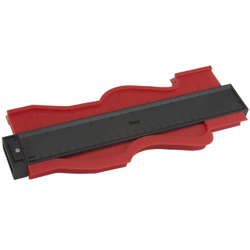

Where can I find a profile gauge?  I've never heard of this.  :tard:
Lotsa places. They look sorta like this...
...but they come in a wide variety of sizes and constructions. Basically, it's a long line metal or plastic rods or flatstock held in a fixture that allows them to move, but stay in place. You straighten them out on something flat, then press it against what you want to profile. The pieces move to match the profile, then you can copy that to something else.
If you do a search for "Profile Gauges", you'll probably find something more suitable for neck profiles.
I'm not following on how that contraption would work like that, Cagey.  I'm sure I could find some YouTube vids or something to get an idea how they would work.
It's pretty straightforward; I just explained it poorly. But, a picture's worth a thousand words. There's a gentleman building a neck who uses a contour (profile) gauge to check his work in this video between the 15:00 and 16:00 minute marks. Have a look at that.
Actually, the whole video is worth watching.
