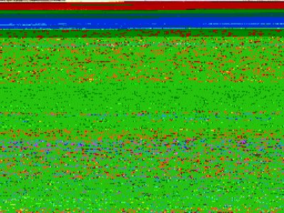

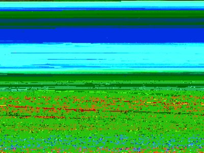

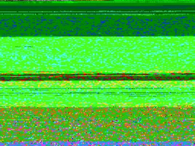

Here's some shots for direct comparison to a strat
Wow. Thanks for posting those pics. That's helpful. I am really diggin' the project idea now. I talked to W today and they said no problem to leave the tuner holes out. "Just put it in the notes at the end."
