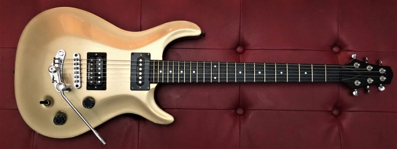

An alternative that I had found to work well for me is this style over a recessed TOM, however, I put on a bridge with roller saddles.
I have a couple of the Dusenberg versions of that. The arm is QUITE long. I cut off the excess and use only the straight portion.
