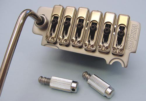

That is very attractive and obviously practical. I wouldn't use a Floyd, though; better designs exist. A Wilkinson VS100, for instance....
Or, better yet, a Schaller (if you can find one)
Otherwise, that's a winner.

I only mean the finish look. The bridge is going to be a ToM. Very much a fan of the Wilkinson though. I have one on a parts mutt I built years ago.
