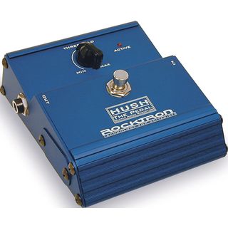

I should add that unless you spend a lotta money, most pedals do add a certain amount of noise, some add more than others, and the more pedals you have the more it adds up. That's a good reason to put a gate-type unit at the end of a chain. But, if the noise level is too high, even that might not be satisfying as you'll have to set the threshold so high you'll hear it kicking on and off. Some of them are better at that than others, so some testing is in order. Back when I played noisy things, I found the Rocktron "Hush" units to be pretty effective.

I look at pedalboards in the magazines, and I have never, ever seen a pedalboard for hard rock or metal that DIDN'T have a noise suppressor/gate on it. And lots of even straight-ahead fatbody jazz guys & country guys often have them. You don't see them in a studio, cause the studio has $8,000 invested in this stuff.
