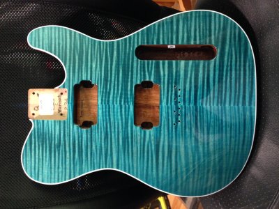

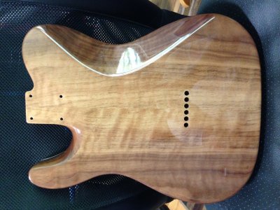

Very, very happy with how this turned out. Flame maple top w/ turquoise dye finish. Body is chambered walnut. Pickguard going on will be a standard W/B/W. I cannot wait to have this thing put together!

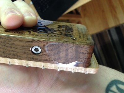

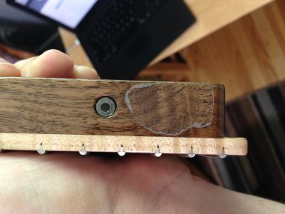

Unfortunately, I have already hit my first snare. When trying to fit my Warmoth tele neck, making sure I went TOP DOWN and very very slowly, I got about halfway when a chip of the finish came flying off. The fit was extremely tight but I have read that's the norm with Warmoth products and it helps with the final results. Any recommendations on how I can "re-finish" this spot to prevent further chipping? Not as worried about appearance since the chip is on the bottom side of the neck.

That's not a "chip". That's a section of finish that never adhered to the wood. Unless you're in a serious time crunch, I'd call that a warranty repair claim. If you don't have time for Warmoth to make it right, you're best bet might be to either leave it alone, or get some wipe-on poly. I think if it were me, since it won't be visible after assembly, I'd leave it alone. What I'd worry about, though, is the quality of finish adhesion on the balance of the neck. Some mechanical stress or temperature changes where the wood and finish expand/contract at different rates could cause similar detachments elsewhere.
What is that wood? Looks kinda like Rosewood. If it is, extra attention needs to be paid to surface prep due to the wood's innate oil content. It needs to be aggressively degreased and sealed before finishing, or you get problems like that.
That's a beautiful Tele body, looking forward to seeing it come together!
Sorry to hear about the issue with the neck. While it won't help you any here, I'd advise refraining from fitting the neck to the body until the neck pocket has been cleaned up of finish accumulation. Finish on the floor of the neck pocket can wreak havoc with the geometry and finish on the walls/shoulders can make for an over tight fit and a possibility of chipping the finish. I use self-adhesive sand paper on a machinists rule to clean up the floor and walls and sand paper on a dowel rod to get the back and shoulders. Inward strokes only as outward strokes can grab the finish and create a chip, and remember you're not trying to remove wood just finish accumulation.
That said, chips from an over tight neck fit are more likely to manifest themselves on the body than the neck. As Cagey said, yours seems less like a chip and more like a flaw. I too would recommend contacting Warmoth.
Thank you for the responses, guys. Will Warmoth still consider taking the neck back even though the "chip" happened when I was attempting to assemble the guitar?
I guess I will give them a call on Monday and see what they say. Like I mentioned before, my main concern is the exposed edges of the finish to start chipping away.

And damn!  What a knockout body!
It's actually walnut! :)

Oh man. OH MAN. That tele body. Yes please. Gorgeous body and neck, dude. Absolutely killer top.  :icon_thumright:
