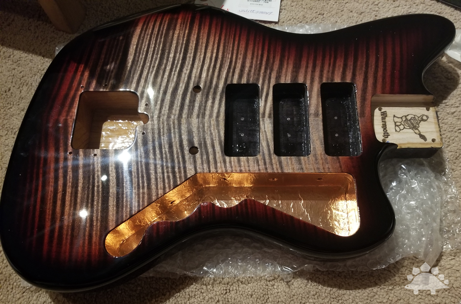

I really loved the Noventa Jazzmaster, but hated all of the available colors - so I set out to build my own. Here it was just out of the box:

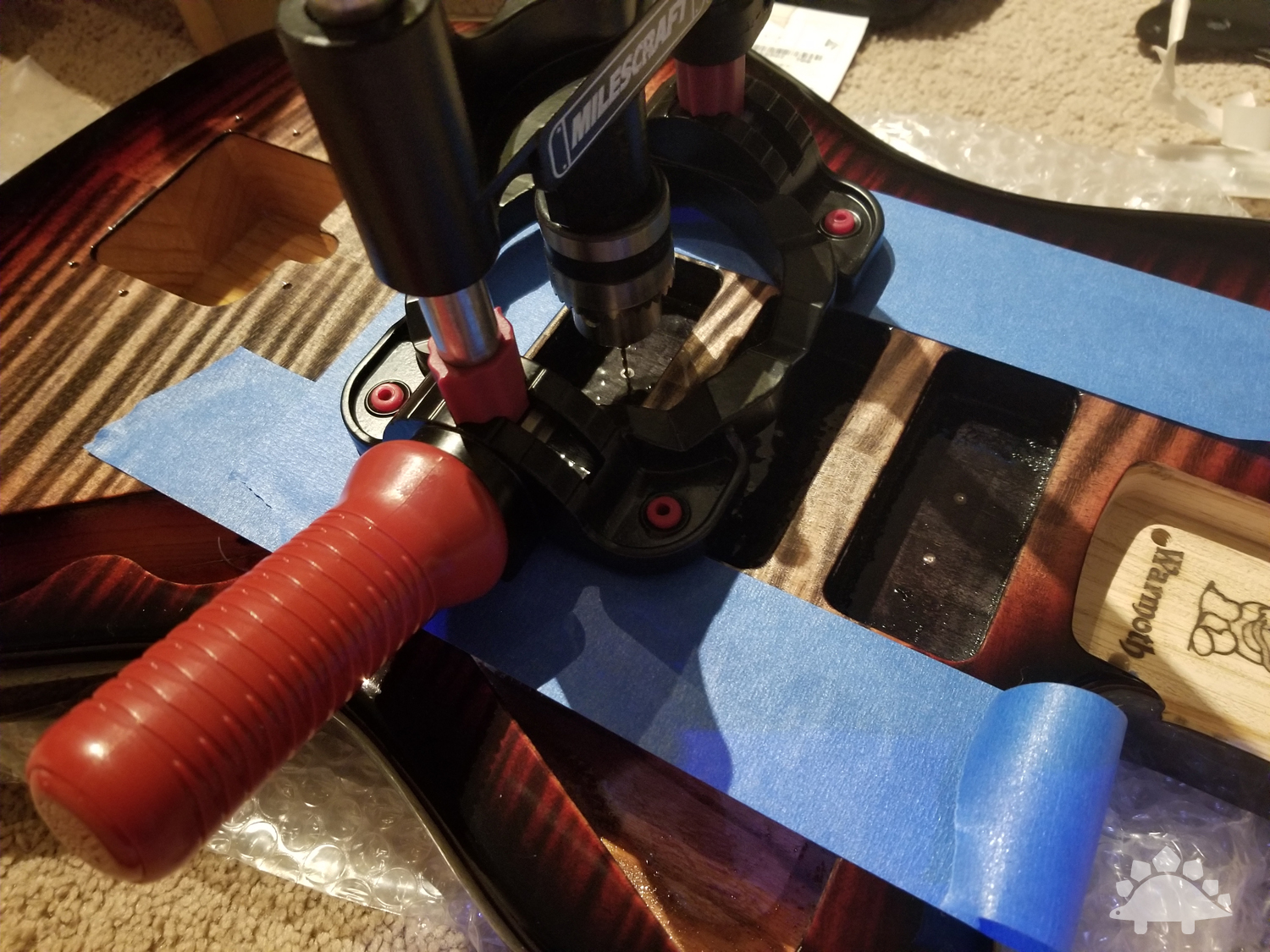

First thing was to go ahead and drill the pilot holes for the pickups. I used blue painter tape to protect the finish and a plunge attachment on my drill.

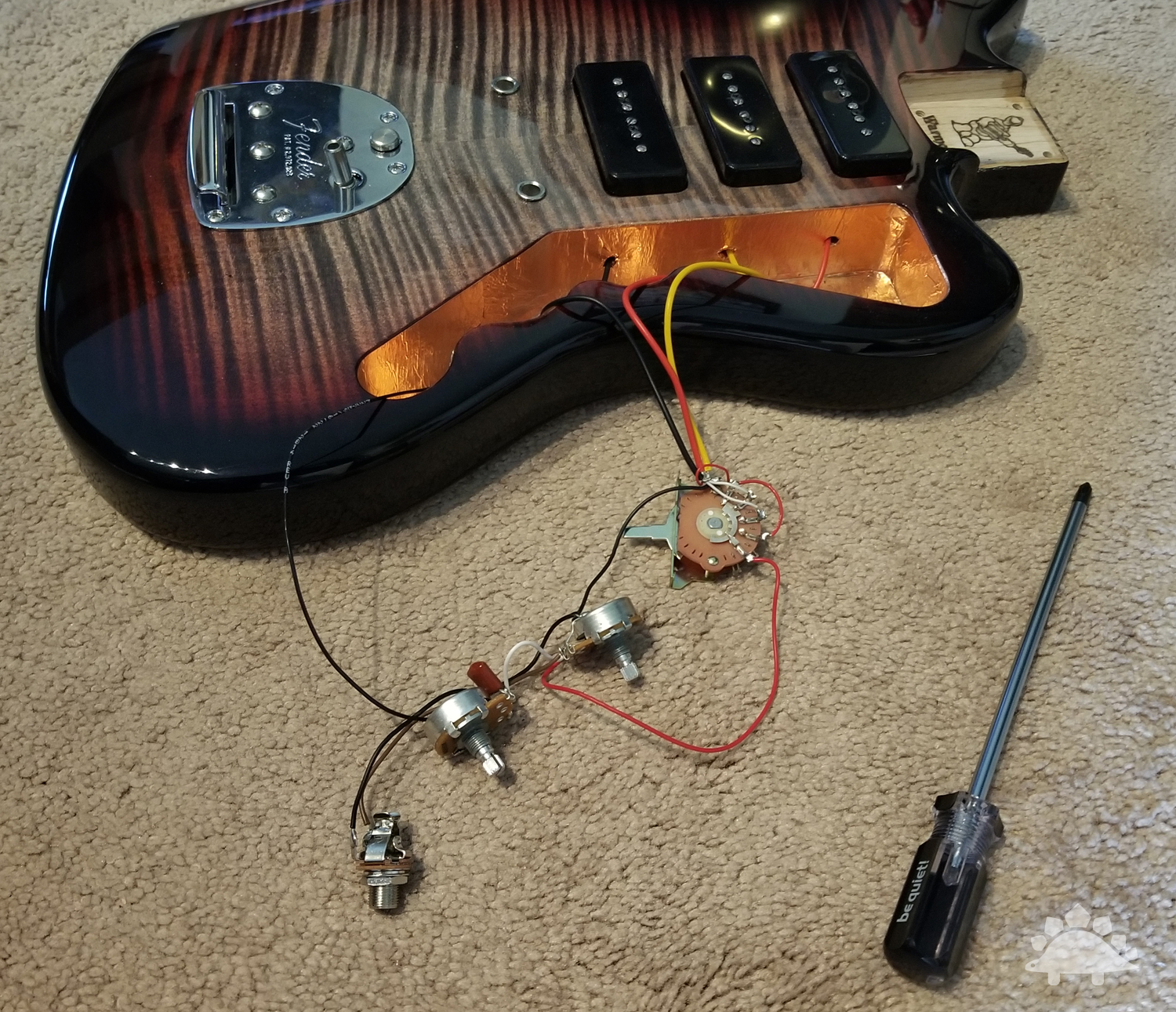

Then I moved on to the shielding:

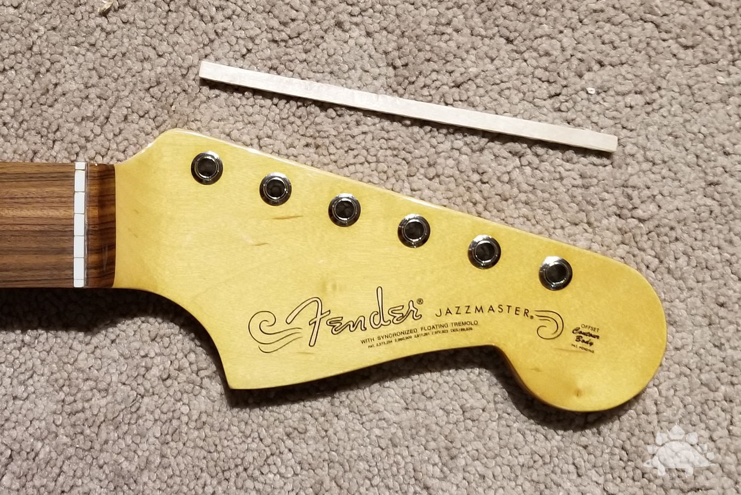

... and as much of the neck as I could do. Unfortunately I lack the tools to dress and groove the nut properly (and don't relish spending $200-$300 to get the full range and fouling up a couple of nuts before I get it right), so I'm leaving that to the Luthier at my favorite local guitar shop.
I'm using an actual Fender Noventa neck for this build as I loved the neck on the original... I just hated the body.
By and large I'm using the electronics from the Noventa as well - I only swapped out the 5-way switch for a 6-way switch and the stock jack for a Pure Tone Mono jack:

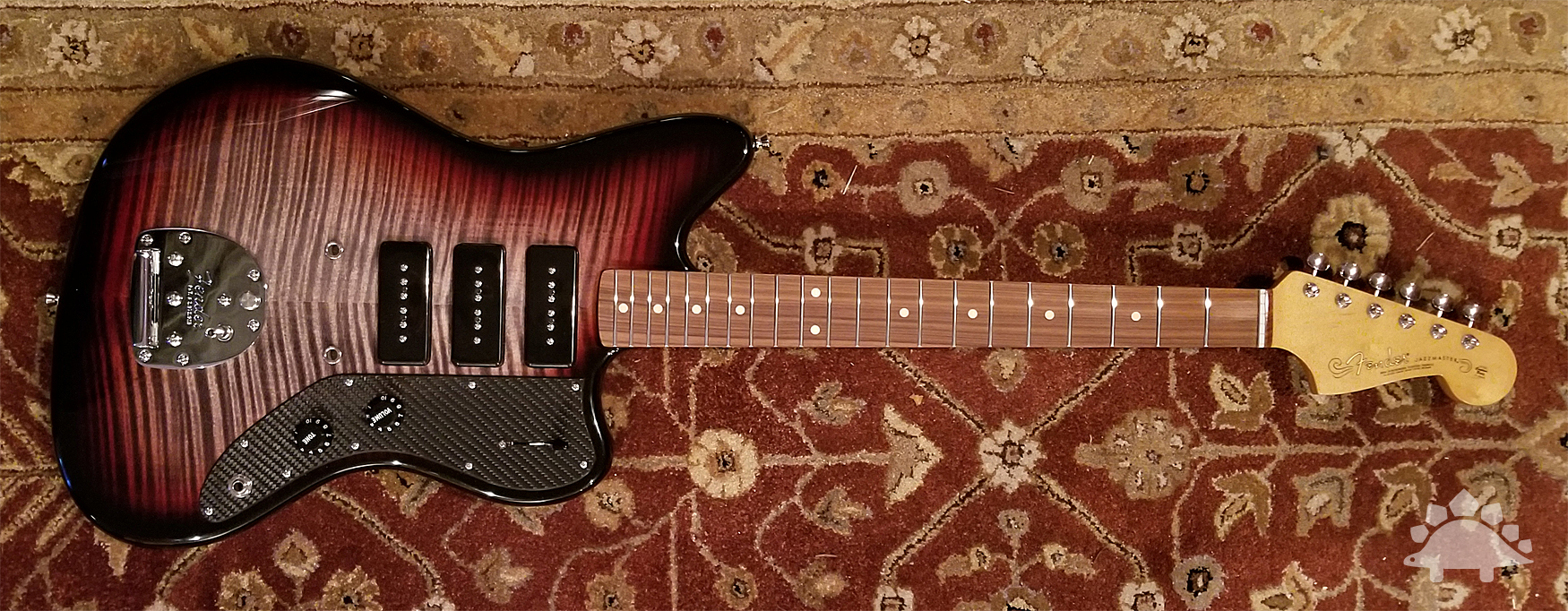

This thing is beautiful, and it is real carbon fiber. So here is the build as it stands:
Part summary:
Body - Warmoth Split Jazzmaster
Neck - Fender Noventa Jazzmaster
Pickups / Electronics - Fender Noventa Jazzmaster
Switch - 6-way Oak Grigsby
Tuners - Grotoh Locking Tuners
Tremolo - Fender American Professional II (upgrade from the Noventa)
Bridge - Fender American Professional II (upgrade from the Noventa)
Pickguard - Halo Carbon Fiber
Can't wait to get it back from the Luthier ready to play...
