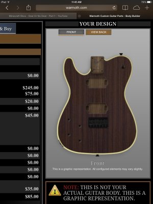

hi my name is Dave and this is my first posting to the website. i have been a guitarist for about 15 years. i am considering building a warmoth telecaster left handed. this is what i have come up with so far. the body will be walnut with an indian rosewood laminate top, LP style controls, contour neck, no belly or arm cuts either, Seymour duncan emty blackouts, single battery box, narrow strat bridge, with all black hardware, cream binding and a tronical tune installed on an all indian rosewood neck. i am not sure how it will sound but these are the specs i want in the guitar. i know it will be a hefty weight being walnut as well. it will cost after all is said and done around $1,600 on the high end of my budget. i was wondering if anyone had any suggestions to help me further. i was thinking of a killswitch too but i am not sure yet. i know the pickups will be right were i want them to be. i have built many mock ups on the actual warmoth website and i am also not going with a paint job being i am going to use tru-oil on the body. the looks of the mock ups are right were i want the guitar to be as well. thanks for any input.

drichards1321 said:
This is the front with the lp style controls
Make sure you ask Warmoth to give you the larger, more open, controls cavity rout instead of the smaller harder to work on, parallelogram shaped LP control cavity shape. You will be thankful for the extra space...
