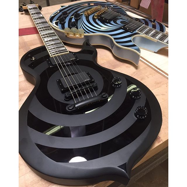

A guy on a Facebook group did one with gloss roses on a matt background. I couldn't find that, but I found this:
That's an interesting finish on that Odin, any idea how it was accomplished? I'm thinking that double spraying, with two different paints, would be a real PITA, but if you look closely at the gloss ring below the bridge, on the left side, it does look like it was masked off and some gloss got under the tape.  :icon_scratch:
I figure you spray the mat first, then apply various sized round stickers.  Then shoot the gloss.
Peel stickers, apply clear, level sand, buff, done.
Piece of cake :icon_jokercolor:
Never tried it, but I suspect you'd have to shoot the gloss first, level/finish sand, buff and then mask and apply the matte. I wouldn't think you'd want to be finish sanding/buffing once the matte was on there, so it seems like it would have to come last.
