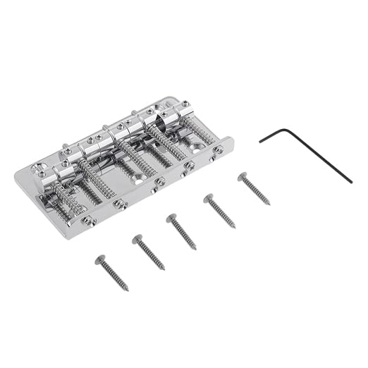

I must be the only narrow p-bass fan out there. The bent plate 5 string bridge with 16.5mm spacing arrived. My 5 string has a 4 screw pattern, not a 5 screw, so I'm still waiting to see if the cast bridge fits closer. Else I may end up making two bridge plates.

I tried a direct saddle swap, but the angle is too great and the saddles tend to pull straight anyway. But it was $8 and I got 16.5mm saddles, so that's still a step better than just $8 worth of education. I got a brake and a drill press. I even have an XY table but it's far too big for my crappy benchtop drill press (which isn't saying much).

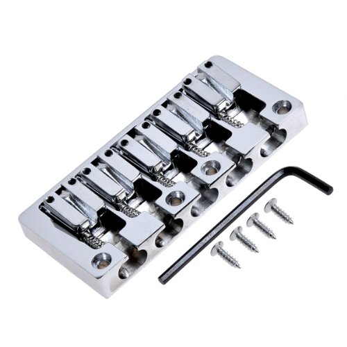

The heavy cast bridge came yesterday, and it's smaller than the existing screw holes on my five string. That one was $10 worth of education. I'm thinking the two choices are either plug and drill the body for the new bent plate bridge, or make a new plate and drill. The biggest hurdle there is actually finishing it - I could saw, drill and bend a plate, but chrome would be too expensive. I used to work in manufacturing, I might could ask a friend to drop it in the cold black line on the next batch, but that's not a given.  Aluminum could be polished up raw, but I don't think a bent plate is a good design for aluminum and I no longer have a mill.
I guess plug and drill is the best route.
