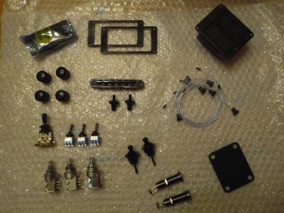

Knobs, Pickup frames, battery box and neck plate are from Warmoth. Pots & switches are from a local store. Bridge is a Tonepros TP6. I've choosen this bridge to match Graphtec Piezo Saddles (there's no enough black hardware around ??? :headbang1: :dontknow .

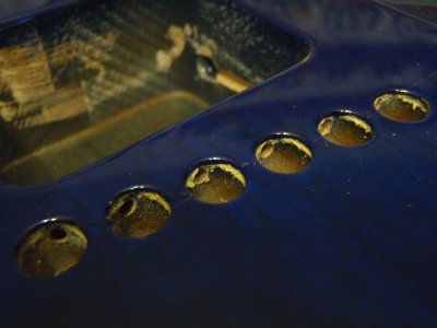

Graphtec installation:

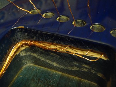

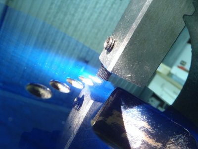

Graphtec saddles are not conductive, so I needed to ground strings properly. I drilled on the back to add some wires and properly ground the string ferrules.
.jpeg [UNSET](35).jpeg](https://unofficialwarmoth.com/data/attachments/19/19430-47a67ec1651397c1efec8b1ea062df81.jpg?hash=R6Z-wWUTl8)
.jpeg [UNSET](28).jpeg](https://unofficialwarmoth.com/data/attachments/19/19429-21638d2376391e3bda5020f5dc1f347a.jpg?hash=IWONI3Y5Hj)
Back ferrules are painted with a black conductive painting. Just to be sure, I filed them and then pressed them into the wood:
.jpeg [UNSET](26).jpeg](https://unofficialwarmoth.com/data/attachments/19/19428-640848e48941dcce30167b1acb48388f.jpg?hash=ZAhI5IlB3M)
Ferrules now touch the copper wires; all is grounded :blob7:.

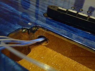

After some more holes:
.jpeg [UNSET](22).jpeg](https://unofficialwarmoth.com/data/attachments/19/19431-8f5d73de87fdb2a625dedf5df314f68f.jpg?hash=j11z3of9sq)

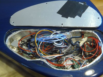

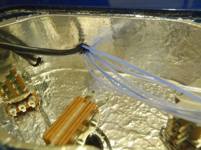

Then I shielded the back cavity and wired the rest...
.jpeg [UNSET](18).jpeg](https://unofficialwarmoth.com/data/attachments/19/19433-cc0a5f2bc380feed44c472b0d573aa1e.jpg?hash=zApfK8OA_u)
.jpeg [UNSET](21).jpeg](https://unofficialwarmoth.com/data/attachments/19/19434-75b7c64c8cf904498045837f725e8266.jpg?hash=dbfGTIz5BE)
There's a LOT a cables!

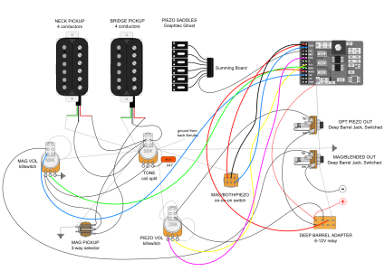

Graphtec list many schematics on their website, but no one were good for my case. I wanted a dual jack configuration using two Deep Barrel Jack (Ibanez Style), so I changed their layouts a little. I will post the full wiring later
Now I have the following configuration:
- A killswitch is ready to use on the Volume knob (pot pulled)
- A push-pull pot on the Tone splits both the pickups
- If I insert a single mono jack only , I can choose between magnetic pickups, piezo bridge or both blended, using the 3-way switch on the far right
- If I insert two mono jacks, I can have magnetic pickups on the first jack, and the piezo output on the second jack. In this mode, a killswitch is active on the Piezo Volume knob (pot pulled)

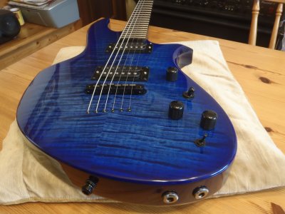

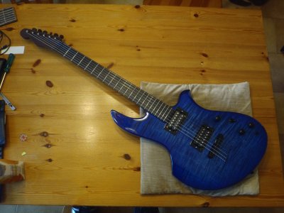

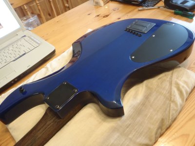

I mounted tuners, oiled the wenge neck and set up bridge and strings. The final result:
.jpeg [UNSET](1).jpeg](https://unofficialwarmoth.com/data/attachments/19/19435-5e9ad4d09a0e504c93a1a3eee53de155.jpg?hash=XprU0JoOUE)
.jpeg [UNSET](3).jpeg](https://unofficialwarmoth.com/data/attachments/19/19436-75104caea78cea2fefe9080bf6071e9e.jpg?hash=dRBMrqeM6i)
.jpeg [UNSET](2).jpeg](https://unofficialwarmoth.com/data/attachments/19/19437-0b67788846499b756defcc63f3404efe.jpg?hash=C2d4iEZJm3)
I hope you like it :glasses10:
