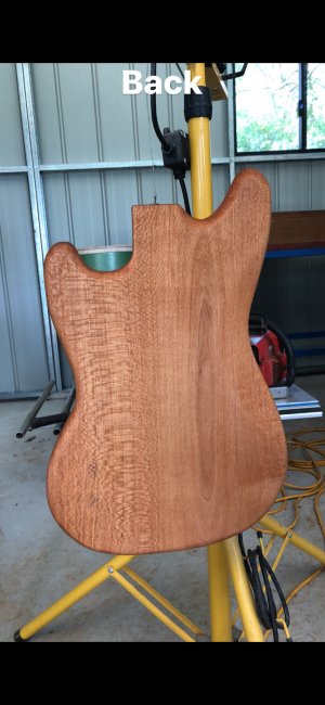

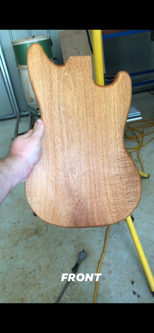

Also, I'm gonna attach a photo of the body I've made out of Northern Australian Silky Oak! (One side looks darker than the other because if the light  :icon_scratch: )
Thanks heaps!

Cheers mate!  Don’t know much about 1 and 2; except I’d make sure my hardware’s measurements meshed with my wood.  On 3, that chunk of wood looks gorgeous.
