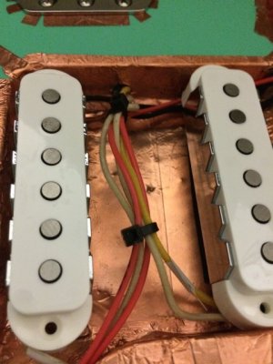

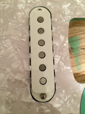

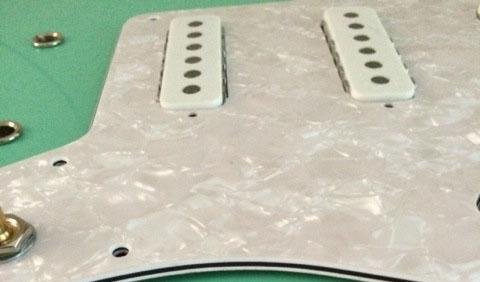

do these help?
the issue is that the pickup needs to come further up through the pickguard. i routed the pickguard holes all the way around the ears to allow mounting closer to the strings. apologies, at the moment i don't have a photo to show you.
screws and tubes/springs would be fabulous, i just can't find screws long enough to go through the ears all the way down into those weird holes in the bottom of the cavity. the neck pickup mounts on the provided screws and some tubing just fine - no holes there.

Ah, I see.
You don't actually need longer screws, if I understand what you're trying to do.  YOu just keep tightening them to draw the pickups further through the pickguard.  Eventually you'll run out of threading on the screws, but at that point the ears will have come hard up against the bottom side of the pickguard.  If you can't get them up high enough, and you're using springs or surgical tubing, you want shorter springs or surgical tubing.

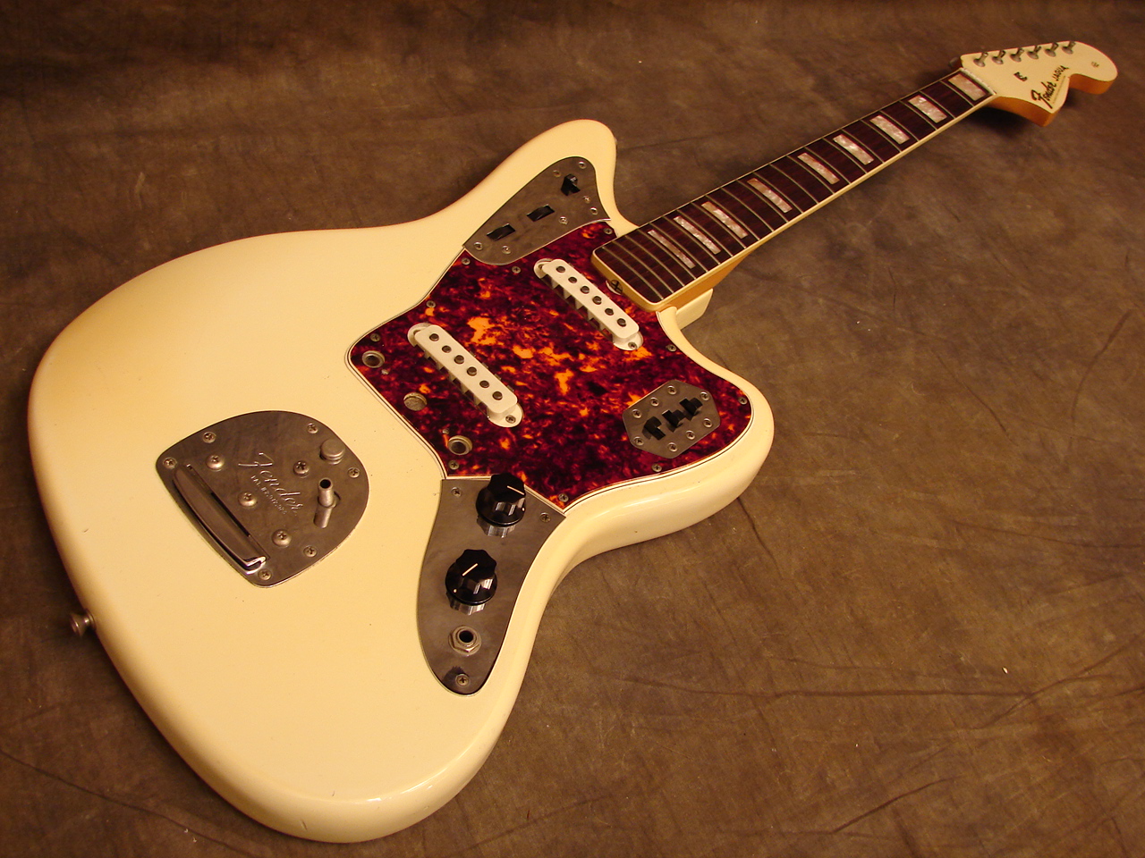

Those look like Jaguar pickups, which are normally not trapeze- or hanger-mounted. You stuff expandable foam under them, then drive screws down into the body. The pickup starts out high, and you adjust it downward from there by driving the mounting screws in. If that's true, it means the pickguard's pickup openings are routed wrong. But, I could be mistaken. On the other hand, it would explain why they won't rise high enough. Pickguard's in the way. See here...

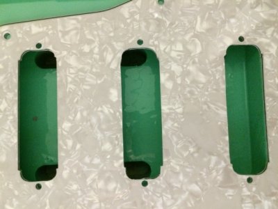

yeah, ken makes his bass 6 pickups like the jags. warmoth routs their pickguards for strats. so i had to do some amateurish filing. :)

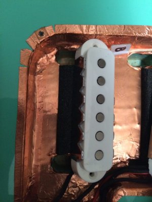

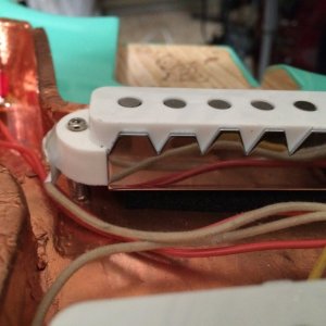

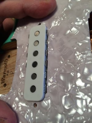

more pictures here. cagey is quite right that the pickups wouldn't rise high enough, so i cut more of the pickguard away (photo 1). i then mounted the neck pickup to the body with the supplied p-90 style pickup screw and some surgical tubing (photo 2). the bridge and neck pickups have ~1/2" deep holes where the screws should go (photo 3) that's my problem.
Last time I fought with a Jaguar, I think I just used dowel to fill those holes. 1/2"? I don't remember. Anyway, it doesn't matter that it won't fill the hole; you're just looking for something to run a screw into. Cut the fillers to length, get some 5-minute epoxy to hold them in and you should be golden. Epoxy is pretty strong stuff. Your pickups will never move.
