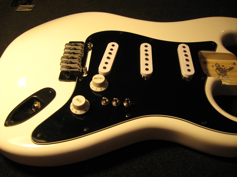

How much clearance should I leave around 1/4" holes that will be drilled through the face of the guitar in to the rear body rout? What is the minimum distance these should be from the Volume hole/pot and the Tone hole/pot? How for from each other?
The holes will be used for On-On Toggle switches to control the pickups, and I want to ensure I leave sufficient space for the toggle controls and the wiring and the tone and volume pots as well.

Tough to say. I replaced the blade switch with three toggles on this Strat...
To answer your question directly, I put them 5/8" apart on center. That seemed to be a comfortable spacing and if I were to do it again, that's the dimension I'd use.
My thinking was that it would be possible to get any combination you wanted, which you can't do with the standard 5 position blade. Doing it this way gets you 7 combinations - 8 if you count "all off". Reality? Not so useful, and actually a pain in the shorts.
When you want to change pickup choice, you not only have to select the ones you want, you have to de-select the ones you don't. It sounds like a petty bitch, but seriously, in practice you don't want that kind of aggravation. You don't have time for it in real life. Blade switch is better.
Incidentally, that's a bleach/arctic/sterile/bright white finish. Camera is lying due to poor lighting. Also, that body as shown is for sale. First $200 gets it. I can do more pictures if anybody's interested. It's very light, that's a Wilkinson bridge, and I think those are Neovin pickups. Have to open it up to check. Noiseless, in any event. Helluva deal. Had an Ebony over Pau Ferro neck on it that's getting re-purposed.
