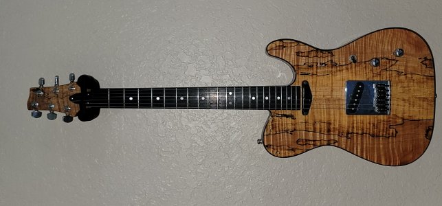

I have this exact combo on my tele.
I did it to lessen the tele's inherent brightness.  I used a set of harmonic design vintage plus pickups as well.  I find that the double truss rod transfers alot of the sound energy to the body, causing it to resonate hugely.
I compared to an all maple neck and didn't notice much difference.  Maybe a hair fatter sounding? It is a fatback after all, lol
