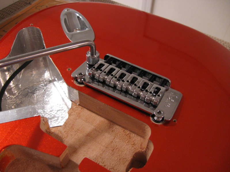

So, despite some early disheartenment, I've made some progress; the result of patience and good advice from fellow forumites. Thanks, all.
Bridge thimbles are installed and, yes, that finish crack will never go away, but the bridge does a lot to hide it. The dimple in the finish -- which happened when the thimble toppled over and cracked the finish -- is mercifully hidden beneath the pickguard. Fools and babies, after all.
Cool! I'm glad that worked out for you.
Thanks, Cagey. You and Stub were right on about, once getting the bulk of it pretty snug in the hole, just giving it a good few whacks. I put a washcloth over the thimble heads and drove them ... gently, but firmly ... home. :icon_biggrin:
In advance of being protege to mentor tfarny, I installed three of the six tuning machine bushings today. It was tedious, but I've learned to be careful (mostly) and take it slow. I met with good results.
I'm interested to see, tomorrow, how it's done with experience and, I imagine, much more specific tools.

I just yesterday finally drilled and filled, then redrilled the holes for the bushings the Schaller Floyd replacement needed on my Candy Tangerine Strat. Then, I used the drill press as an arbor press for the first time, and was quite pleased. Worked like a charm, and no dangerous hammering. Wish I'd have thought to do that in the past.
