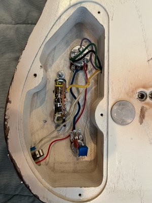

I need a nonstandard rear route for a Tele body. See attached pic for example of what I want. Does Warmoth have pictures of their rear route options anywhere? By email they said to request a "bean" route, but I'd like to see what that would look like. Thanks!

Too lazy to take the plate off. This is a rear-routed tele.

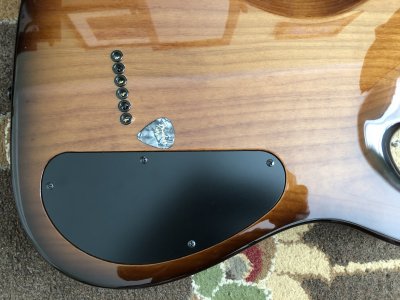

The rear route on the tele body is the same rear route as other warmoth rear routed bodies afaik
Thanks! Sounds like I don’t need to request anything special then. I’ll select “rear route” on the body order form.
Note: If you select LP controls on a rear rout Tele body you'll get a smaller, diamond-shape cavity. Just be sure to select Tele or Strat control layout and you'll get the kidney bean cavity--same shape used on rear rout Strats/Soloist/Velocity/VIP/etc. Some of the bodies have their own RR shape, but they're usually the more esoteric designs, such as the Musiclander, WGD, Diamondback, and V shapes. Mildly interesting: the Jazzmaster and J Bass share the same rear rout shape.
