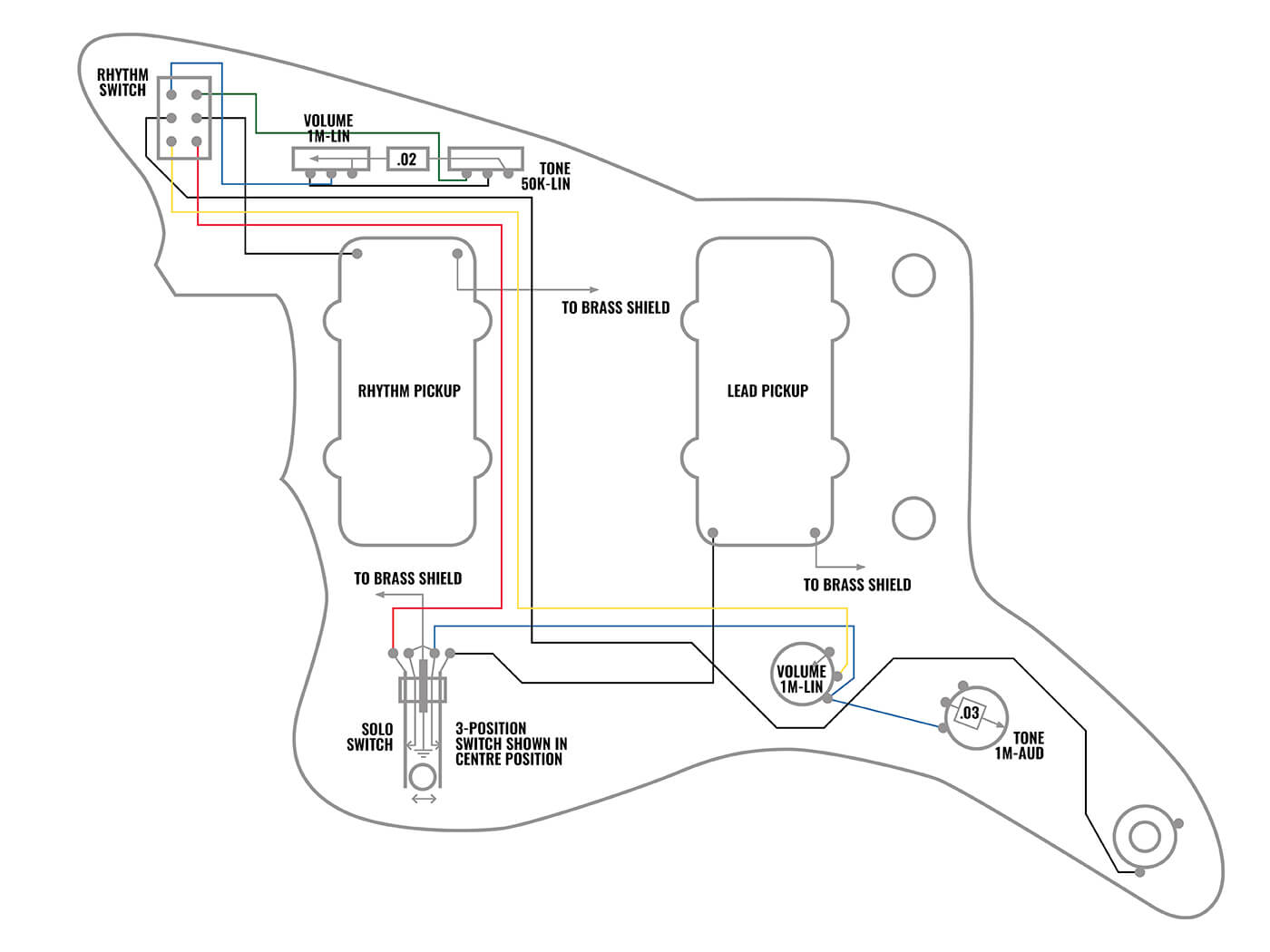

Over the years, I have wired many guitars, but I am wiring my first Jazzmaster.
The parts I bought have two of them (fender pickups and Toneworks wiring kit), and I could use some wisdom on that, and a correct wiring diagram might go a long way too.

I've never used toneworks kits. Sounds like you bought it from them. My first stop would be to ask tone works. Wouldn't they include a wiring diagram? Makes no sense not to. In any event, next I'd head over to the seymour duncan site and peruse their diagrams. It's always a good idea to get diagrams, schematics and a parts list before building.

When it says: "ground to brass shield," what is it talking about? Is that the copper shield tape, the bridge, or is there a part I need to buy?
The back of a stock jazzmaster pickguard has (had?) a thin brass shield attached... (i think they have been aluminum in recent years)
see https://reverb.com/ca/item/35714006...master-pickguard-aluminum-shield-usa-62-62-66
There are also aftermarket copper ones (easier to solder to!) but I would probably just make due with fashioning something out of thin copper foil...
