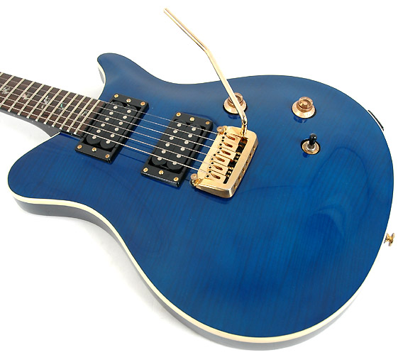

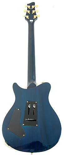

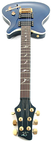

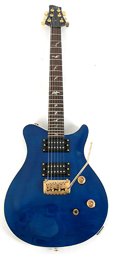

I was trying to see about which fret the neck heel finishes from photos. It was about 21st. (pardon the typo in the photo, was copy+pasting... :icon_scratch
Then I found this problem. Since the neck core finishes around 21st fret, the neck pocket had to be further out, and that made the only contact between the neck and the body being base of the neckpocket.
Like this... (the upper square-like place is the neckpocket; if I can call that a "pocket")
I can screw the neck in, and the guitar will make noise for sure, but would this kind of design be considered a bad one? because there isn't much of area of contact and vibration won't transmit as much?
