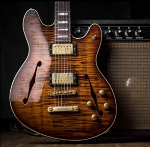

1. ES335 looking ? s+See the attached picture....
