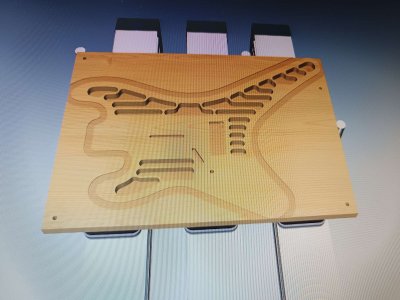

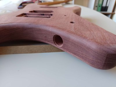

I'm working - among other things - as an instructor/teacher for CNC woodworking. So, while waiting for my Warmoth parts I thought about HOW I could make a guitar body myself. I had never done anything like that, but I like to learn and try new stuff.
I started experimenting with guitar shapes in AutoCAD, which resulted in so many ugly looking designs :ROFLMAO: until I came up with something that looked kinda like a Charvel star and a Kramer superstrat had a baby.
I thought that would look great in purple, so I planned to build this out of purpleheart and buy a purpleheart neck from Warmoth. But as purpleheart is heavy but very hard and stable, the idea was to sandwich the body out of a heavily chambered front and back.
All of this planing, programming, gathering materials...that took months, which was good, 'cos it made the wait for the other parts feel shorter. And it made me appreciate more what they do at Warmoth.
Since the order I was waiting for, was a 7/8 S-Style body and neck, I designed the new body around a 7/8 Warhead neck and wrote the CNC program with variables. That way, the moment the neck arrived, I could just take final measurements, make some tests and check if everything fits, build the body and check again if everything fits, before ordering the new neck.

'Cos purpleheart is so strong, I could even make the covers in the back out of it.

Dang! I am wildly impressed with the CNC work. I’ve seen many builds where the operator wasn’t confident in having the CNC do the more detailed work (cover recessed) but it looks like you got the whole thing roughed in in one pass!
I'm not 100% sure if I understand what you mean, but look at it this way:
The sole purpose of the CNC machine I used for this, is to teach people how to operate and program a CNC machine. I even made it a lesson about making that body, explaining what I do and why, measuring every tool/router bit precisely and so on.
And this was a long program btw. Purpleheart is brutal! It's so hard on the tools and in order for it not getting burned I programmed A LOT of passes at rather high speed.

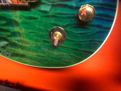

Outstanding work ! I’m a big Purple Heart fan, I’ve done 3 PH neck builds and one more on the shelf. There is a guy, Guilford Guitars, on Reverb that makes PH switch tips.
