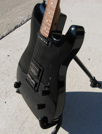

Done it with a maple neck.  Ms Nesbit tells no lies.  She's fat, sassy, twangy, clean, and nasty all in one.  Some pre-setup pics..Push/pull volume pot splits the HB for classic Tele tones.
You better keep an eye on Ms Nesbit. She's a fine lady. If Al Green has his way with her the world might not be ready for their love child.
Even though I have messed with a multitude of wire diagrams as experiments, I always seem to end up right back here with this exact config.
It just "works" for me, especially live, simplicity.
