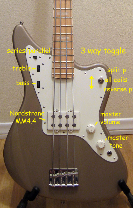

How hard would wiring like this be?
The wiring for those options is more on the complex end, although if you simplify it into sections it's not too terrible.
The nice thing about his page is that it shows pics of how he wires them up.
The components I see:
split/norm/reverse
series/parallel
2 band EQ
volume/tone
A good space-saver would be a rear mounted 9v battery, it looks like the Warmoth Jazzmaster IV bodies aren't routed as much as John K's. The upside to the battery route is that you wouldn't need to remove the pickguard when it comes time to change it out (about once a year, maybe less if you play a lot or forget to remove the cable from the jack often).
