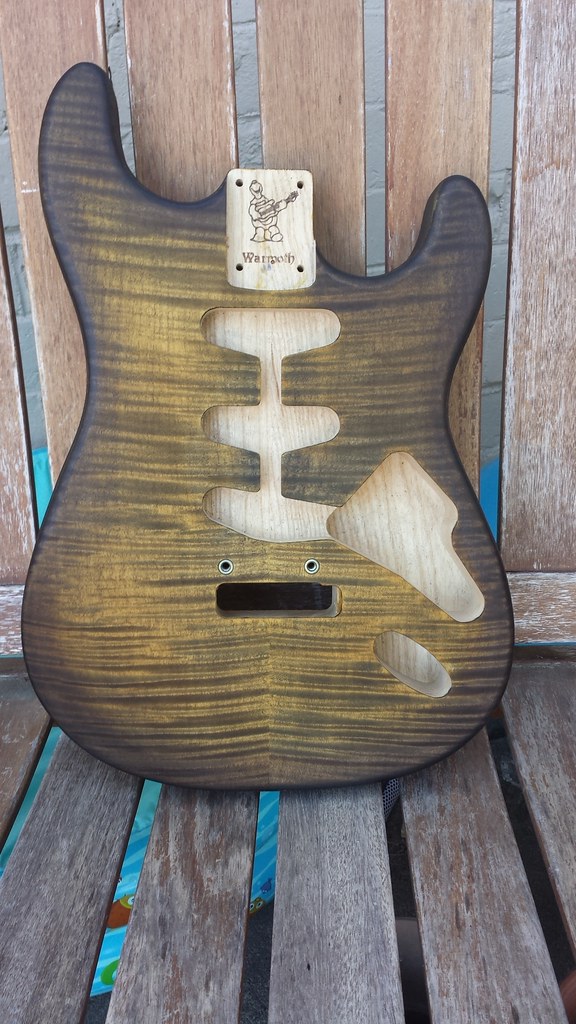

I've done this one as follows, on swamp ash with a maple droptop:
1.  Sand to 220
2.  Wet the entire body to raise the grain
3.  Sand back the whiskers
4.  Repeat 1-3
5. Wet the body again - you should not get as much raised grain.
6.  Apply dye to taste.
7.  Allow dye to dry and then dewhisker gently - you don't want to burn through your dye.
8.  Spray with shellac to seal; allow to dry overnight
9.  Scuff sand  - quick'n'dirty with a 320 pad
10.  Apply grain filler (in this case, only on the exposed swamp ash portion, since the maple is very tight-grained).
11.  Sand back, re-fill and re-sand x3 (swamp ash - jesus, what a drag to fill this stuff)
12.  Apply another quick wash coat of shellac and allow to dry overnight
13.  Get going on the tru-oil.
14.  Next step will be to wetsand, since I have a good buildup of tru-oil, and I want a gloss finish.
The photo below shows the dye job before shellac wash coat and filling, but I think it's pretty so I just want to show off.

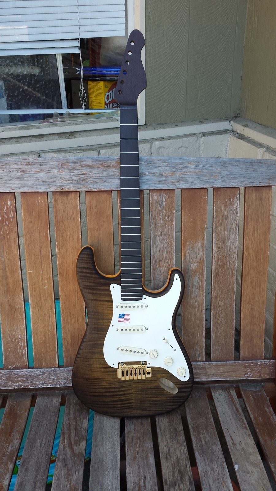

Tele-me about it said:
I wonder, what kind of neck are you pairing it with?
I was thinking of pairing it with this wenge neck with an ebony board (shown here in a mockup I did before I settled some issues with my burst), but that may be too dark, visually - I'm contemplating an all-maple job instead, now.

I can kinda see why you'd go for different woods on the neck -- that is a LOT of black after the fact.  I think the maple idea would be a perfect match for it though!  Maybe even something like canary or another light-colored wood.
A maple neck, maybe with some subtle birdseye figure, would look killer on this body.
I think I might consider Canary for that one. Raw necks are so sweet, especially polished. But, Maple would be good, too. You're right - it needs something lighter than the Ebony/Wenge. Be sure to get gold frets to match the hardware. Very much like stainless.
