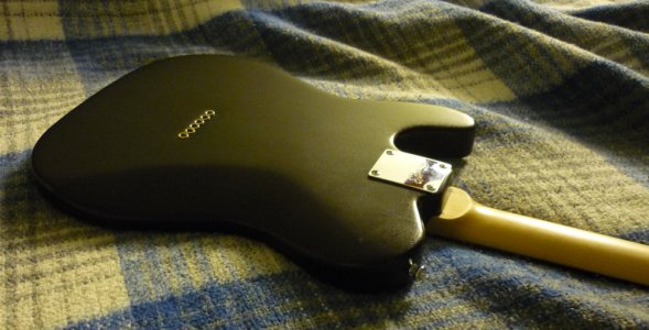

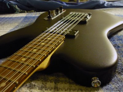

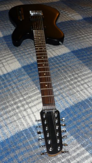

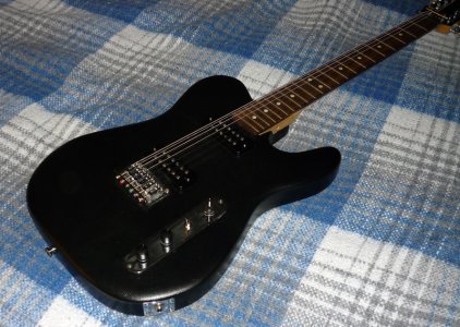

Its Black and it has double the strings and a set of "double" p90s so "Double Black"  The neck is a modified Warmoth, it was a 70s style SmurfHat headstock that I rounded over. I made the body out of three pieces of alder.  Jack Plate and Control plate attached by machine screws into threaded inserts so I can take them on and off as much as I want without wearing the softer alder wood out.  P180s from GFS. Controls are Three-way Les Paul style pickup selector, coil tap switch (taps both pickups at the same time), Volume, Tone. Gotoh twelve string hardtail bridge, Gotoh Tuners. Finished with Rust-O-leum spray on Lacquer.
