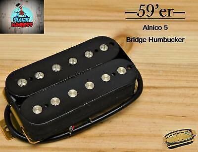

One of my guitars has a pair of Musiclily humbuckers with alnico 5 magnets and 7-8 kohm resistances. They do a good job of sounding PAF-like. Any of the Asian made buckers with that range of resistance and alnico magnets are probably the same or nearly so, but you have to watch out because most of the ones listed for the bridge position are around 15 kohms. The pair of Musiclily pickups were about $20 delivered, from eBay.
This eBay listing might be of interest to you:
