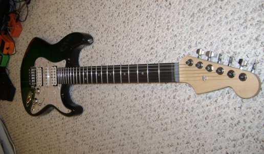

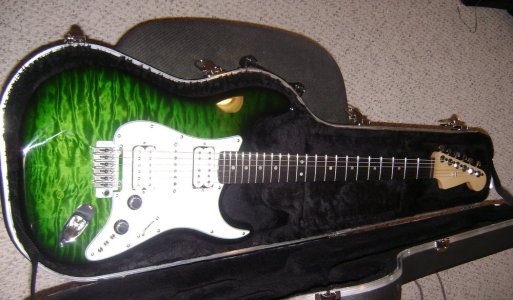

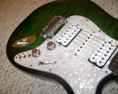

It's sort of a Warmoth build double faux-pax. I made a green guitar, AND top routed a quilted top. But... It's exactly what I wanted from day one and I'm extremely happy with the results. It sounds great, unplugged even. Sustains like you wouldn't believe. Thick and chunky with the humbuckers, and completely stratty with the single coils/splits. Besides the standard strat 5 way switch, I wired it with 2 on/on/on switches to give each humbucker series/split/parallel, plus another on/off switch to engage the bridge PU at any time. Baskin Robbins has 31 flavors, this guitar has 31 Pickup combinations.
I may not use all of them, but it's nice to know they're there.

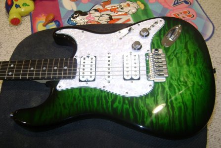

This picture actually captures the top pretty well. The pickguard is pearl, the camera flash makes it look pure white.
