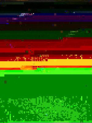

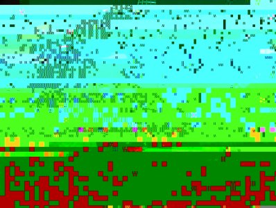

Just adding some pic's for you, of pickup-less guitars. ie: just using GK-3 or Graphtech
(these ARE NOT mine)
1st is a Warmoth with graphtech .... rough job on the 13pin install  :doh:
2nd is an old Variax with GK-3  :sad1:
They just look sad & lonely without normal pickups  :sad:
