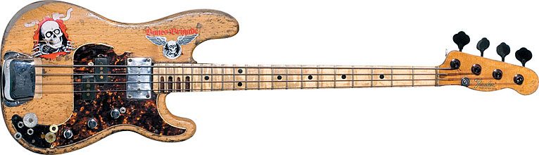

. . . maybe a head adjust?  "Vintage Modern" for bass, maybe?  It would be kinda cool to have the ability to have a pickup in the "mudbucker" position (right up against the butt of the neck) on Fender style necks.  Not just because Billy Sheehan did it:
but because it's a great spot to put a pickup to catch some LOW frequencies. Is there some technical reason Gotoh side adjust can't be done on bass?
