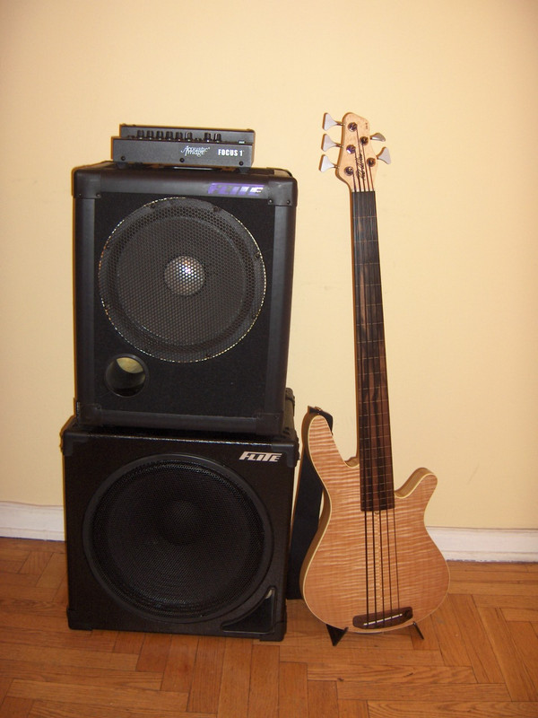

But most of your list -- piezo pickup, 35" scale length, chambered body -- describes my Rob Allen MB-2, which is probably the most upright-bass sounding electric bass I've ever heard.* Also an acoustic guitar-style bridge, and nylon tapewound strings.
*Wait, let me amend that: It sounds the most like what electric bassists think an upright bass sounds like of any electric bass I've ever heard.
But it is a phenomenal sound.

This photo brings up the other side of the equation: amplification. It stands to reason you’d want some pretty massive speakers to get the low end, in your chest oomph you get standing near an upright.

Yep, agreed, there are lots of great fretless electric tones but none of them sit in the mix, especially live, the way the upright does. I think IR (impulse response) tech can help bridge that gap, but conventional bass amp speakers just don’t project the way the top of an upright does, and then you’ve got to account for the Helmholtz resonance of the f-holes.
To truly chase that I think you’d need a much more massive ported cabinet with a huge speaker sitting behind the band.
