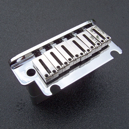

I was thinking of this Fender part...
versus the Gotoh 510T-FE1...
You're right, they're not identical, but someone might call it "close enough" to get the better wang bar mount while maintaining appearances.
Cagey,  ok yes I see where you are coming from. There is a similarity but the Gotoh to me has a look and feel of better quality. I guess my focus is more on those differences.
The other Gotoh with the curves I'm starting to like the look of a bit more too.
