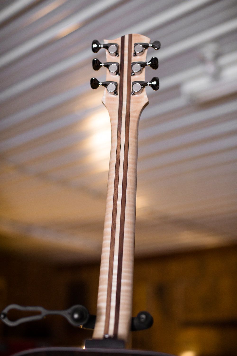

But I don't think I want a guitar neck glued up out of a bunch of small blocks just the same.
I hear you ... but still people seem to like necks made of several pieces ...
:cool:
The neck laminate shown is side to side glued along the necks' length. I cannot remember seeing one that is glued end to end across the neck to create a longer piece.
I have never seen that either, but still, it could be interesting to see if there's any impact in tone/sound/sustain ... from a solid neck versus a multi ply neck.
But now we're getting off topic.
