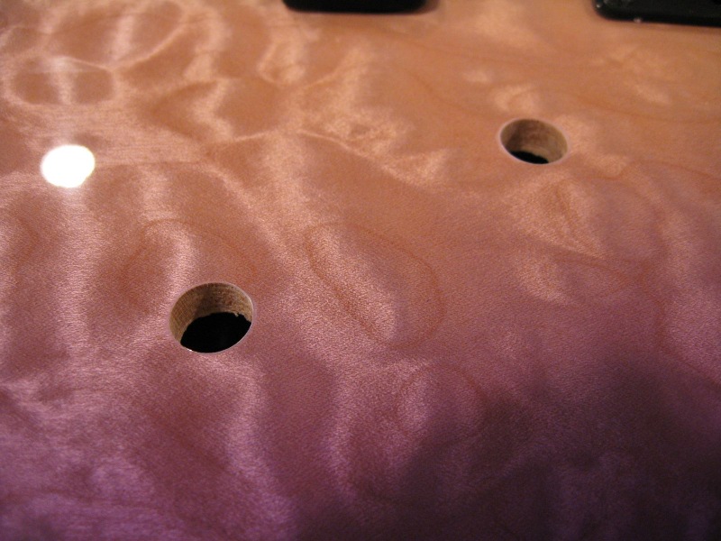

Thanks for the tip!  I'm sure this won't be my last project, so these will be worth getting.  I got really lucky that I didn't severly mess this up... :doh:
Yeah, twist drills can really tear up a piece of wood. Then if it's finished, they'll chip the hell out of that as well. The Forstner bits slice around the outside of the hole before they start to bite into the center area, so even on hard high-gloss finishes you get a perfect hole. For example, these were done with a Forstner bit...
Just be sure to drill from the finish side, not the back side. The exit side of the hole won't look as good as the entry side.
Another feature of that style bit is they drill flat-bottomed holes. You don't always need that, but sometimes it's a Good Thing.
You can put a piece of scrap wood pressed under the one you're drilling, to avoid tearing on the exit side (you can actually do that on both sides, although this is not necessary with a forstner bit). In french this piece of wood is called a "martyr", I don't know what is the proper term in english.
Sometimes it's called a "sacrificial piece", but more often it's just called "a piece of scrap wood" <grin>
