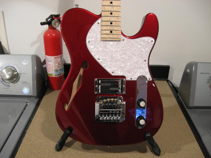

Stubby's right about the router - you can do one helluva lotta serious damage in a hurry if you're not comfy with one. Be sure to practice a LOT, or get someone else to do it. Fortunately, the routing needed for a Kahler is not as extensive as it is for other styles of bridge. I did one on a Tele last year for a gentleman in England and it came out well.
