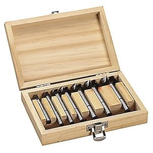

Thank you for telling me about the Forstner Bit. I'd never even heard of em before but I looked them up and they seem quite affordable. Very impressive outcome as well (Thanks for the pic.) My father may have one but If not I'll definitely make sure he gets one.

They're not bad price-wise for individual bits, but you may want to look at the smaller sets of 7. They usually run from 1/4" to 1" in 1/8" increments. Often, by the time you buy two or three, you've paid for a set, so you may as well get the other four for free. Never know when you might need them. If your dad doesn't have any, it would be worth considering a set as a gift and a "thank you" for his help. All woodworkers love a good tool, even if they don't know they need it <grin>
Just so you know, you run those bits slow, especially in hardwoods. Otherwise, you'll burn the wood and may remove the hardening from the tool and dull it prematurely. There's a lot of surface area to the things, which generates a lot of friction and a surprising amount of heat. Also, they don't work well in hand drills. You'll want to use a drill press to keep them true, and also to get the torque you need to spin the little rascals.

If you can, spring for the German bits, either Bosch or Freud. They make the best ones. You can get them cheaper, but you'll end up throwing them away sooner.
I did a little pricing on the bits. The prices on the Bosch made me want to crawl into a corner and sob so I checked the Freud and they seems quite a bit more affordable. Although I does seem that buying those three bits separately would be quite a bit cheaper than buying their set, the set itself, when doing pricing on all 7 individual bits, is quite a deal. Will I need those other bits because It's a difference of nearly 30 dollars? If I would need them I can see why it would be a good Idea but If not should I save my money or will they be a good enough deal for other uses in woodworking?

If most of what you do is guitar work, the three sizes I mentioned are good for 99% of the jobs you need to do. A more general-purpose shop would use the others more often.
