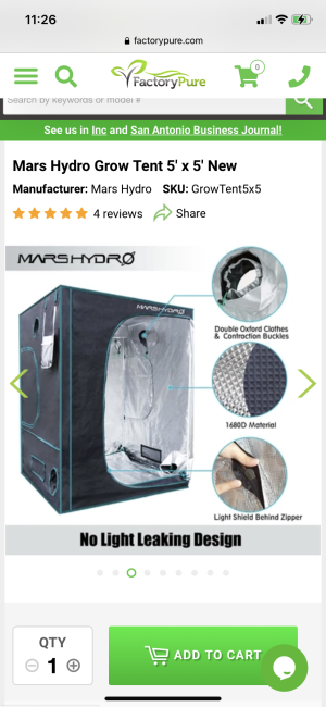

Well that is the plan, but just adding the tent for added cover and maybe some temp control. And then just run it back inside between coats. Also I assumed that with the sun hitting the tent it would warm it up a tad inside if it’s a colder day

Why not, give it a shot.  though with a tent you have to figure out breathing, if that's a concern.  I suppose it all depends on how much spraying is going on.
Plus you can use the tent afterwards to start your favorite herbs.  When I've used spray cans on cooler days I heat up the can in some hot tap water for a couple minutes.  As I said, I have no experience with nitro.  Nitro is probably trickier than, say a wipe on oil.

It is not something I would want to attempt. You need more consistent temperature and humidity.

Well unfortunately that’s not an option for me, I guess I will just have to go through the extra steps and make sure that the temp and humidity is right before and after spraying

Not to dampen your spirits but be prepared to have perhaps a less than straightforward process. You might end up with more steps and different results than you may prefer.

Well it seems I’m out of options. If a sealed, dehumidified, and heated tent won’t work. I guess nothing besides a garage or professional spray booth will work. Guess I’ll be sending it back

It might work, I am just saying it is less than optimum. Finishing is not really a shortcut or time saver generally speaking.
If you can shoot the nitro in the sun on dry 60°F days, then it might be fine. Nitro isn't as much temperature sensitive as it is humidity sensitive, but cooler temps can make rattle cans splatter and drip. With solid colors, those drips can be leveled after all color coats before clear coat. But, as stratamania noted, if you're shooting in less than optimal conditions, then you're going to a more difficult time and more issues could arise. I live in a high humidity area, so I shoot April-May and Sept-Oct. and that's about it, and I'm not above ordering a finished body.
You haven't said if you would be shooting on a patio, balcony, common area, or what, but you need to be able to isolate yourself from the rest of the tenants. Nitro fumes are high VOS, it another tenant can smell the fumes, then it is harming them, plus the fumes can combust if they find a spark. Not really high-density living friendly.

Don't get discouraged , sometimes people get negative on internet forms . There's a lot of self-righteousness on the internet.
I've done a lot of spraying and your paint booth idea is a good one . I built a booth by hanging plastic sheets .
I like your idea better . The thing is you need to have a fan  to draw the fumes away. I have a old oven exhaust fan mounted low on the floor . Unfortunately you shouldn't just use any old fan  it should be blow proof ( won't catch fire) as lacquer fumes can ignite. You also need a filter , mine is up high in my booth . I have a cheap harbor freight paint suit and respirator mask , around $35 total.
What  people have said about humidity is very true , I use a little humidity gauge, only spray 55 % or under .
