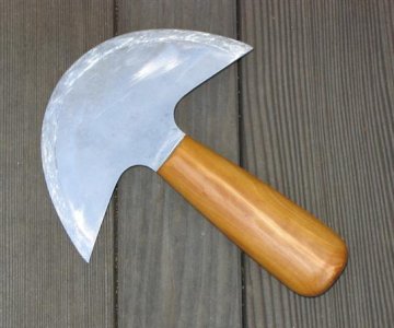

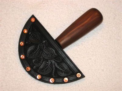

As an aside, in leather working, we call that ebonizing process 'vinegaroon' or 'vinegar black'. On oak tanned leather, it produces the richest black and doesn't rub off. I've used that on wood, too and it is a nice way to darken it. Here's a before and after photo of a leather knife I made and did the handle with it. I also did the sheath, for that matter. I may have to try that with a guitar one of these days.

I haven't tried it yet, but the fact that it gets right into the pores and grain makes it attractive. Probably won't show wear, since the beauty is more than skin deep. Plus, I'll bet it doens't take fingerprints and smudges the way a hard finish does.
It acts on the tannins in the wood. Try a sample and if it doesn't take well enough, give it a good coat of strong tea to put tannic acid into the wood first. Then it will work better. Some of the leather workers soak their leather in tea before applying it if the leather may not have enough naturally.

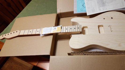

Understood, but I haven't connected anything yet and I will clean with denatured alcohol and a good air spray.
