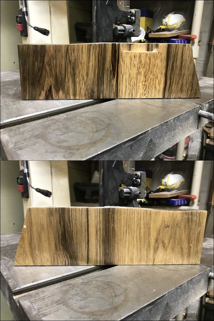

I am at that point right now, a black limba body that I've been waiting for ideal temps to spray with lacquer. Except that I'm reluctant to disassemble it as I play the bejeezus  out of it, can't get enough of that roasted neck!  :bananaguitar: I was thinking of doing black grain filler, but the look of the wood is "busy" by itself, and am wondering if the black grain filler would put it over the top. I'd really like to find a pic of black limba with black grain filler, but I haven't come across one yet.
Been playing with a cutoff, one side is "clear" grain filled and the other, black. The clear side I filled with CA, and cant stand using it. The vapors are hideous, and it loads up sandpaper quickly. The black is a spackle/acrylic paint mix I saw someone do on youtube. Real easy to do, dries quick, and doesn't load sandpaper at all. For the black, I brushed on some shellac first, filled, and sanded. I would in practice spray on a coat of shellac afterwards as a seal coat, but I just wanted to evaluate the look, so just sprayed a couple of coats of lacquer on both sides and took the pics. I'm really liking the black grain filler. I'm going to look at it, then not look at it for a while, then look at it again to see if I still like it  :laughing3: :laughing3:
[youtube]JmvA7oWGb40[/youtube]
The black grain fill looks good to me but if you wanted the clear look, there are other types of grain filler.
