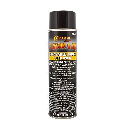

AAAAnd here I have a little problem.  Apparently Super 77 isn't the amazing be-all/end-all product I heard it was.  This is upsetting because I had stretched everything nicely over the corners with a heat gun and all of my seams were perfect.  I can't salvage this, I don't have enough material to stretch it taught to the right spots.  I was happy with the look, but not the material, the Vinyl wasn't instrument cabinet grade, if there is such a thing. and it got damaged easily.
So what should I do here?  I want to rip it all off. Clean off the shmutz, and do something easier.  Maybe something roll on, or a stain?  I think the rounded edges of the plywood would look weird with a stain.  I wouldn't mind a paint on texture, as long as it isn't so aggressive it takes chunks out of drywall or scrape your knees up.
Anybody have some pointers? I just want to yank the vinyl off, clean it up, and have something quick and easy.
