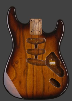

dying a roasted swamp ash body then grain fill and seal with solarez
drgprov
1
Looking for to dye a roasted swamp ash body then grain fill and seal with solarez high gloss. does anyone have any experience with what dye works best with solarez? attached is a picture of a roasted swamp ash body and I am looking the to do a one color similar to the center of this tobacco burst body.

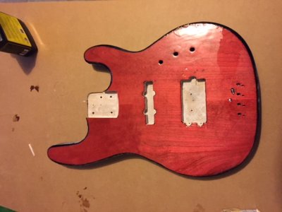

I used Keda aniline dye on alder with Solarez. I bit off more than I could chew since I had zero experience with finishing. I really liked the color, but had so many lumps, blemishes and sand through that I had to start over with another body (I purchased a kit from Carvin/Kiesel).
Michael
There you go!  It works.  It's the finish application that is tricky.  The dying part is simple.
