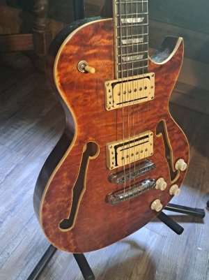

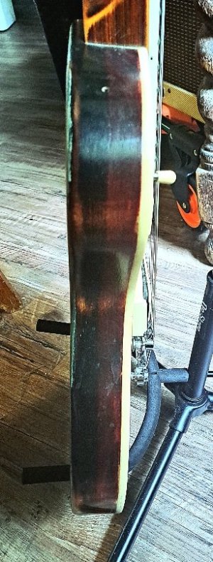

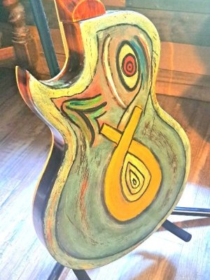

I have keda dyed dang near every type of common guitar woods except basswood. Heck I even did my cedar deck after I burned it. It is pretty forgiving and straight forward really. You can sand it back iffin' you don't like it. I say go for it! I like to wipe the wood down with rubbing alcohol after sanding to remove any oils etc from the wood before I start.
