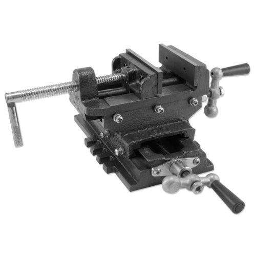

A handy thing to have along with that is an X/Y cross-vise...
Allows you to do things like install threaded inserts in necks.
