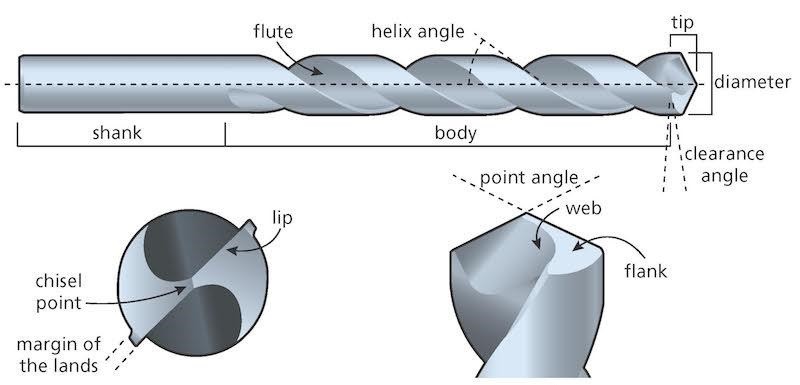

I thought this might come in handy, can't just keep buying new ones. It seems like a simple thing but it's not. But it's not impossible either, just takes some practice.
This here is a twist drill bit. I suspect you already knew that, but it gives a nice view of the various parts. The best point angle for hardwoods is 45 degrees to the center line of the bit. And it makes a difference even though it wouldn't seem so. too sharp an angle or too shallow an angle will change the size of the hole your drilling plus make it harder to keep a straight depth line.
