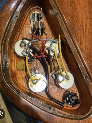

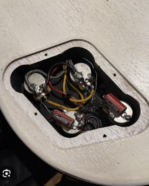

They’re foundationally two different layouts. The volume/tone are closer together and the control routing is much larger in the SG to provide space for both the toggle and the input jack.IMG_2127.jpegIMG_2126.jpeg
That is not the case on a rear rout tele, though. If you choose rear rout, the cavity will be the same size regardless which controls you choose.

Thats not true. The Strat/Tele and I believe thinline layouts all share the large Warmoth cavity. The LP layout has a LP size cavity.
I don’t think the Tele has wide enough hips to support the exact same orientation

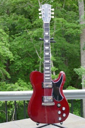

Which is why I want the SG layout. The vol/tone pots are more in a square shape and less diamond like the LP. That bottom volume pot is essentially where the input jack would be placed. I’ve seen the SG layout on tele.
Also the SG isn’t as wide as it looks. It’s only due to the “waist” being cinched in the middle. The tele and the SG are both 12.75” inches wide.
