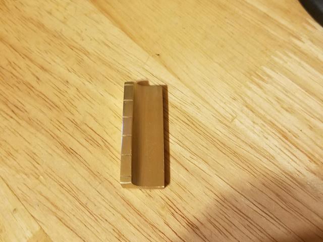

I can solve the neck dilemma, I made a brass nut for someone some time back who was doing the same mod. As for the body, you could glue in a piece of wood in the route, it's been done before, easy peezy...
