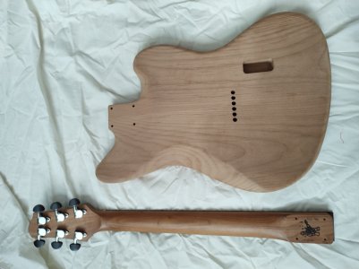

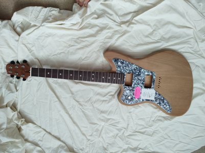

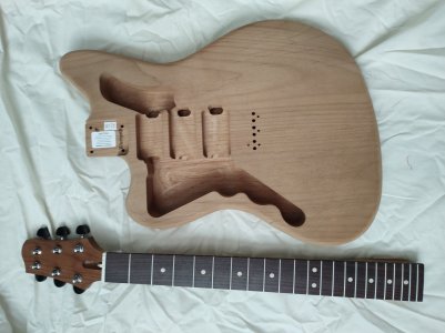

Quality seems good and I think I got quite lucky with the grains everywhere and darkness of fingerboard. Relieved that the neck size and shape (59 roundback 1 3/4) which was a total punt seems great in the hand.  I predict an easy build  :laughing7:
For the weight weenies, body is 1930g or 4lb 4oz in old money, and the neck is 533g (without the tuners)

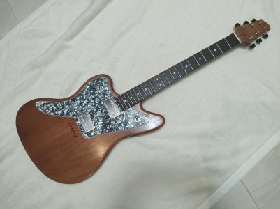

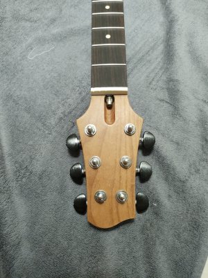

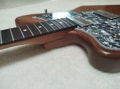

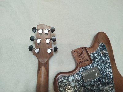

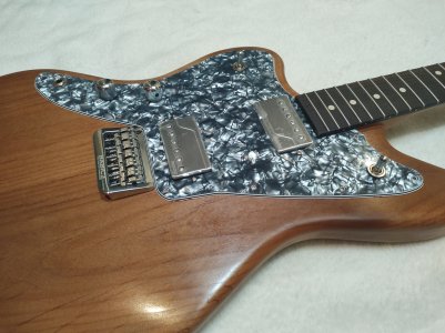

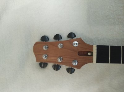

I burnished the neck, lemon oiled the board, improved the fret ends with 400 and 600 sand paper, rolled the board edges with a screwdriver, sanded and applied first 3 coats of Tru oil. All very rushed and underdone but I wanna play this thing!
Having some difficulty adding pics from Android
Nothing screwed in, soldered or bolted down yet
