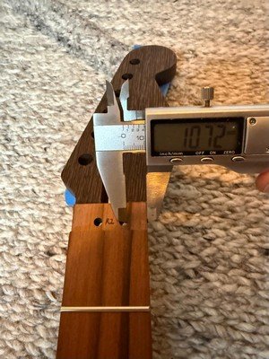

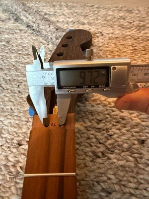

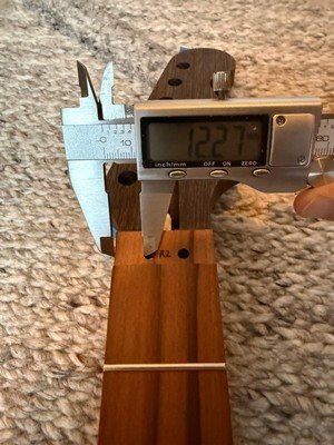

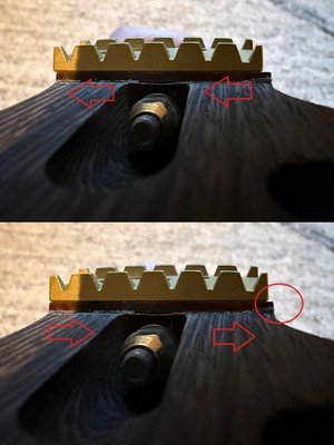

I ordered a custom neck in December 2025 and finally had time this weekend to install the hardware. When fitting my FU-Tone brass R2 nut, I found it won’t sit square on the nut shelf, it ends up slightly misaligned.
I measured the nut and it looks basically on spec, so I moved on to the Warmoth nut shelf and the mounting holes. With the usual Floyd button-head bolts (with the grip washers) there’s minimal lateral adjustment available. With cap-head M4 bolts I can shift it a fraction more of a millimetre, but the nut still doesn’t sit evenly on the shelf, and I’m hesitant to torque it down against wenge when the contact/pressure looks uneven. Adding M4 washers to even pressure distribution reduces the lateral movement again.
Here’s a photo showing the limits of adjustment I’m getting with cap head M4 and no washer:
I’ve also attached some caliper photos with the measurements:
I’ve contacted Spike at Warmoth and I’m waiting to hear back. In the meantime, I’d really appreciate any input:
