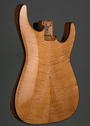

If that bridge would work I'd say carved top Soloist. You're probably stuck with a flat top though.
Here's some food for thought
Yeah, I looked at a soloist, but the tilt-back Warmoth neck would look out of place I think, and yeah, it's gotta be totally flat.  Gonna be a phone-in custom order because the specs to drill for that bridge and those tuners are not an option to select online.  I really am thinking the VIP is going to be the way to go.  Maybe "hollow" but with that section for the bridge left solid (as can be requested).  Two F holes.  Two knob holes.  Done in satin.  Maybe Koa on mahogany?

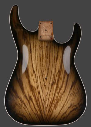

Lord have mercy:
Can you believe how beautiful that thing is?  Cost is close to 9 bills.  Can you imagine it in a Warmoth satin finish?  That new black Dialtone pickup plus the Hannes bridge, and then the unfinished solid 3A vintage/modern Birdseye Maple neck with big gold frets?  It would be a shocking piece of tonal bliss, I imagine.  Ok.................it's round about midnight.  :glasses9:
