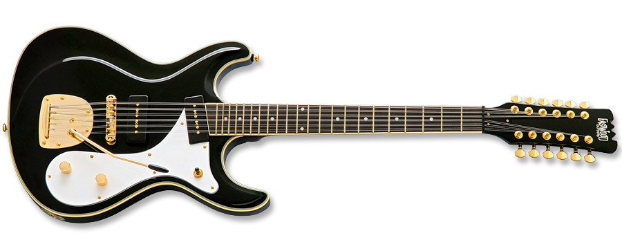

Eastwood make a 12 string with a (presumably modified) JM style trem:
